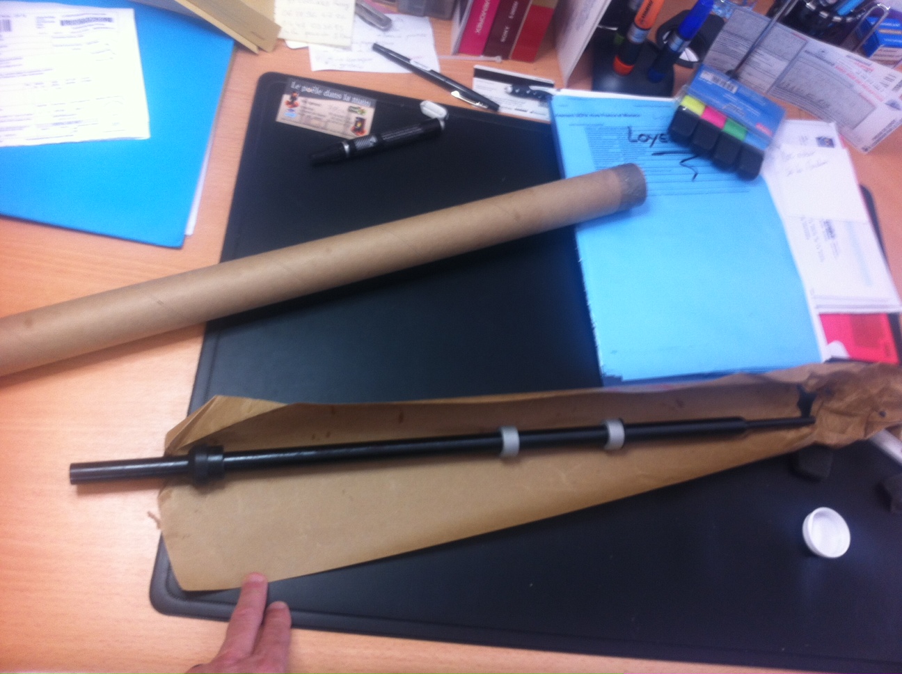

| Canon 24 recu et sans douane coolI have just uploaded these images: une bonne review je trouve et fort complete http://nzairgun.com/forum/index.php?topic=610.0 | |
